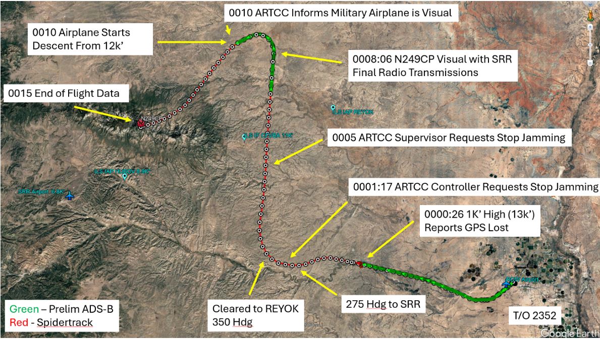

A military GPS jamming exercise is drawing renewed attention after new reporting suggested it may have contributed to the May accident of a Beechcraft King Air in New Mexico that killed four people. The accident remains under investigation, and no official probable cause has been determined.
According to the report, the twin-engine aircraft was flying from Roswell to Ruidoso when it encountered GPS interference during an electronic warfare exercise near White Sands Missile Range. The crew reportedly lost reliable satellite navigation while approaching mountainous terrain at night. Three other aircraft in the area also experienced GPS disruptions during the exercise, suggesting the interference extended beyond a single flight.
The report said the loss of GPS left the medevac crew with limited navigation capability during a critical phase of flight. The aircraft subsequently struck a mountainside, killing both pilots and two medical crewmembers aboard.
While investigators have linked the GPS outage to the sequence of events, officials have not concluded that military jamming caused the accident. The findings remain preliminary pending completion of the investigation.

  4. Sometimes these GPS jamming exercises result in position errors that aren’t obvious to the pilot. If your GPS fails, then you usually get a message on the display. Military jamming can cause the displayed position to freeze and you might not notice it in time to switch to another nav aid, especially at night in low visibility in the mountains. The area covered in the NOTAMS is so large that you can’t reliably predict whether or not it will affect your flight.

  7. Not to mention GPS jamming has been going on in this area and others for decades. Dealing with this would’ve been a very regular part of this crews flying in that area. It’s disgusting that so many are trying to blame this on the military and GPS jamming when it was simply a flight crew’s mistake. Also, don’t forget they were flying an approach not authorized without local altimeter which wasn’t available. Sounds more like this slots in under “gotta get there” than anything else.
  8. Avatar for RonLee RonLee says:
    This is nothing more that someone trying to find an excuse for the poor pilotage. They could have flown using a VOR or followed a road. Heading north when they needed to go westerly was a fatal mistake. They should have known about that mountainous area.
