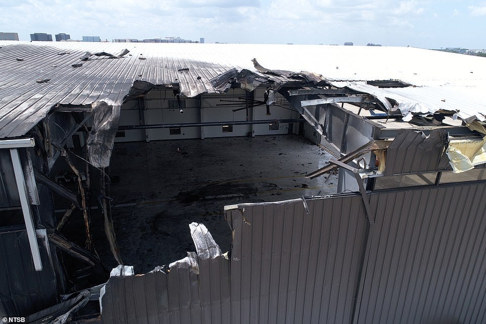

The privately owned and operated King Air was departing Addison on a flight to St. Petersburg, Florida. Both pilots and all eight passengers died in the fiery crash into the side of a hangar.
