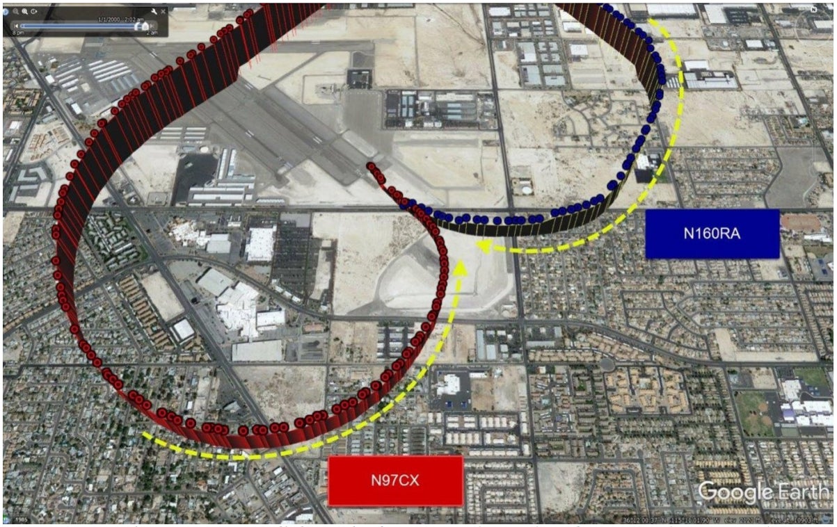

  • Despite the separate runway assignments, ADS-B data published in the report suggests that both aircraft were lined up for Runway 30R when they collided approximately 0.25 nautical miles from its approach end.
The National Transportation Safety Board (NTSB) has published its preliminary report on the fatal midair collision of a Piper PA-46-350P Malibu Mirage and a Cessna 172N Skyhawk at Nevada’s North Las Vegas airport (VGT) last month. The report confirmed that the Piper, identified as N97CX, had been instructed by air traffic control to fly left traffic for Runway 30L while the Cessna, N160RA, had been instructed to fly right traffic for Runway 30R. The board found that the aircraft collided approximately 0.25 nautical miles from the approach end of runway 30R. ADS-B data published in the report, shown in the image above, suggests that both aircraft were lined up for 30R.
