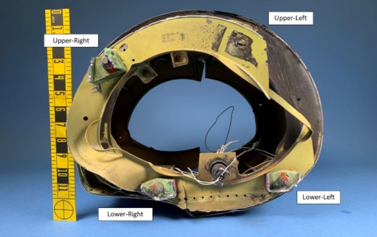

  • This recommendation follows an investigation into a Hawaii crash where a Bell 407's tail boom separated in-flight, attributed to missing or fractured attachment hardware.
  • The NTSB specifically recommends reducing the current 300-hour inspection interval for tail boom attachment hardware to a more conservative number, noting the accident aircraft failed after only 114 hours since its last inspection.

The NTSB’s report (PDF) stated that the upper left tail boom attachment hardware on the accident aircraft was missing although the attachment fitting was still connected to the fuselage. Investigators found the remaining three fittings and hardware still attached to the tail boom, noting that one of the fittings had multiple fatigue fractures and two had overload fractures. Alongside immediate inspections targeting tail boom attachment hardware, the NTSB is recommending that the interval for torque checks of the tail boom attachment hardware and visual inspections of the tail boom attachment fittings be reduced from the currently required 300 hours to “a more conservative number.” The tail boom on the accident aircraft was found to have separated just 114 hours after its last inspection.
