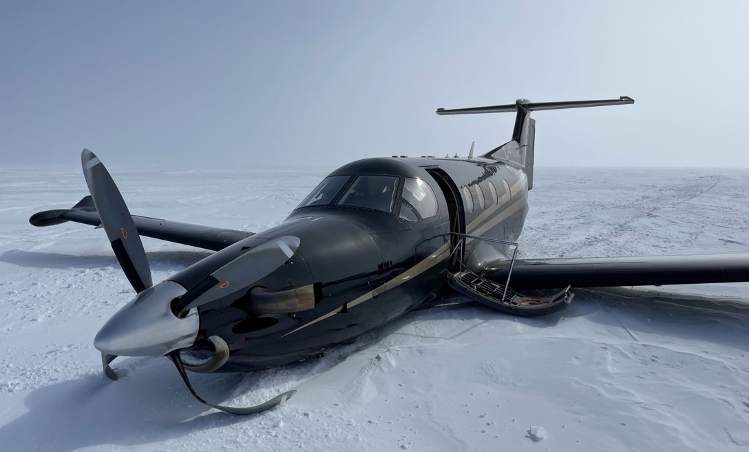

The report said the aircraft was descending toward Rankin Inlet Airport on May 7 when the engine emitted a series of bangs and flames appeared from the exhaust ducts. Power dropped sharply moments later.
The crew declared an emergency after attempting to remedy the power drop and aimed for what they deemed the safest available surface—a patch of sea ice roughly five nautical miles east of the airport.
The PC-12 touched down with its landing gear retracted at 9:51 a.m. local time. The emergency locator transmitter did not activate automatically, but the crew manually triggered it, and the signal was relayed to the Joint Rescue Coordination Centre in Trenton, Ontario.
Local Royal Canadian Mounted Police officers and firefighters reached the aircraft by snowmobile about 80 minutes after the landing. All occupants were wearing safety belts and shoulder harnesses, and they exited the airplane without injury.
The wheels-up, off-field landing did not result in any fire or accompanying fuel or oil leakage.

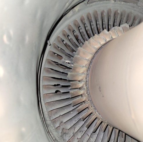

The engine— a Pratt & Whitney Canada PT6A-67B with 4,558.4 hours and 2417 cycles since the last overhaul—remained largely intact after the landing, but investigators found extensive damage in both power turbine stages. Blades in the two stages experienced midspan fractures, the agency said, with most fragments exiting through the exhaust ducts. The compressor and combustion sections showed no abnormalities.
View of the occurrence aircraft’s 2nd stage power turbine with broken blades when looking in through the exhaust duct [Credit: TSB]
A metallurgical examination found that the blades met manufacturing material specifications and showed no evidence of fatigue or degradation. Instead, the fractures were consistent with tensile overload. The report stated the cause of the blade failure could not be determined.
Investigators also noted galling and overheating signatures on bearing surfaces in the propeller reduction gearbox, though the source of that damage was also not identified. Oil samples taken from the gearbox were discolored and contained particles rich in lead and copper.
