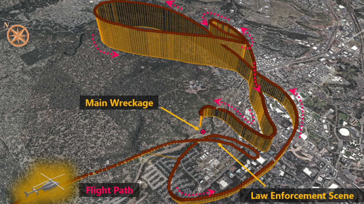

Flight tracking data investigators reviewed showed that the police helicopter departed its base in Kingman, Arizona, at about 9:10 p.m. and flew east toward Flagstaff. Once in the area, the crew coordinated with officers on the ground while circling the neighborhood and using onboard infrared equipment to help monitor the suspect’s location.
During the operation, the helicopter maneuvered at relatively low altitude while conducting surveillance over the neighborhood.
At one point during the mission, the pilot climbed and maneuvered to allow another helicopter inbound to Flagstaff Medical Center to pass through the area. After the other aircraft cleared, the Bell 407 returned toward the neighborhood where officers were working the incident.

Video reviewed by investigators showed the helicopter maneuvering north of the neighborhood shortly before the accident while appearing to position for a vantage point over the scene.
At about 10:16 p.m., the tactical flight officer began a radio transmission to officers on the ground. Seconds later, the helicopter entered a rapid right rotation.
Investigators reported that the sudden rotation coincided with an unidentified sound transmitted over the radio, followed by two loud bangs believed to have come from the helicopter itself before it began a rapid descent. During the descent that followed, the tactical flight officer transmitted, “we’re going down.”
The helicopter came to rest on a dirt access road about three nautical miles north of Flagstaff Airport. Investigators said they documented a debris field that extended more than 6,000 feet from the main wreckage.
