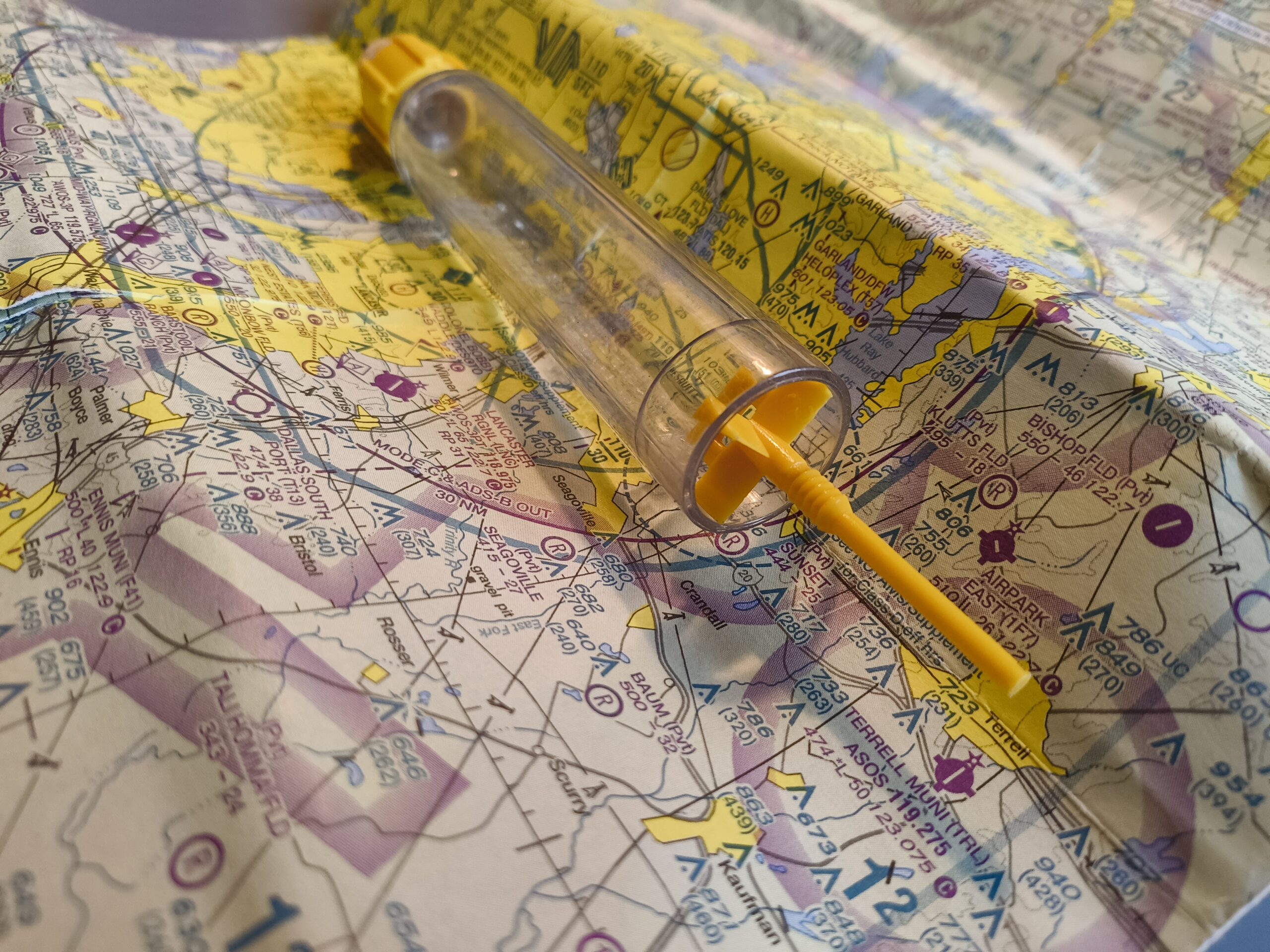

The airplane’s 116-gallon fuel system was topped to the tabs with about 80 gallons of 100LL aviation gasoline before departure.
Witnesses later described a brief walk-around preflight inspection. The pilot checked the oil and circled the airplane once, but according to statements in the NTSB’s final report, no checklist made a discernible appearance during the preflight and the pilot was not seen drawing fuel samples from either tank.

Samples from the sump tank, the engine-driven fuel pump and the right engine carburetor bowl all contained water and debris.
Investigators also discovered another small but incredibly significant detail. The right fuel cap was missing its rubber gasket, the seal designed to keep rainwater from entering the tank. The gasket should have been detected during the airplane’s most recent annual inspection, and indeed, could have been discovered with a thorough preflight inspection.
With the airplane parked outdoors through weeks of rainfall, the missing seal was the likely culprit that allowed water to enter the fuel system.
The NTSB concluded that the accident resulted from a loss of engine power caused by water-contaminated fuel that went undetected during the preflight inspection. It also pointed to the earlier maintenance inspection’s failure to identify the missing fuel-cap gasket as a contributing factor.

Fuel contamination is one of the most well known and simplest-to-check risks in general aviation, but it’s also one of the easiest to skip in a pinch.
Flight begins before the engine starts. Just as we can’t make our planes fly faster than they’re capable of going to save time, so we also can’t compensate for a time crunch by rushing or skipping a preflight. That preflight inspection step is as much part of the flight as a takeoff roll or a stabilized approach. If a thorough preflight will make us late, we can either accept that we’ll be late, or we can choose not to conduct the flight in the first place.
A thorough walk around, confirmed by both our good sense as pilots and our checklists, remains by far the simplest defense against a departure that ends far sooner than planned.

  2. Rushing is never a good thing. 2 speeds; slow or stupid (thanks Barry Schiff). Try running the engine(s) long enough for them to die from fuel starvation (while on the ground). That should be a minimum time that engines run prior to takeff. That detects if the fuel valve is off or broken, or if you did not notice water in the fuel lines (but did sump). And if you sump after top off, wait several minutes for water to settle down to the sump. If you pour a mix of 50% water and 50% fuel into tanks already half full and immediately sump, the odds of detecting water are very slim!
