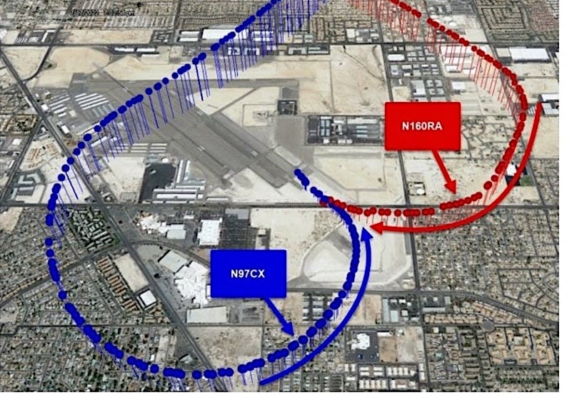

This diagram shows the flight paths of the Piper Malibu (blue) and Cessna 172 (red) involved in the July 2022 fatal midair collision. Credit: NTSB

The second aircraft, a Cessna 172, was on a training flight with a 47-year-old student and a 40-year-old instructor. The Mirage was cleared from the north for a left downwind to the visual approach to Runway 30L and acknowledged the clearance. The Cessna was executing touch-and-goes in right patterns for Runway 30R.
Despite having acknowledged clearance to land on Runway 30L, the Piper overshot the centerline, overtook the Cessna and collided a quarter mile from the approach end of Runway 30R. According to the report, the tower controller did not issue an advisory to either aircraft. He told the NTSB that, in addition to his normal four 10-hour weekly shifts, he had worked an estimated 300 hours of overtime that year, with no anticipation that the workload would diminish. He said he was fatigued on the day of the accident but felt that it did not affect his performance. He said it was customary to have two aircraft on opposing patterns for the parallel runways.
