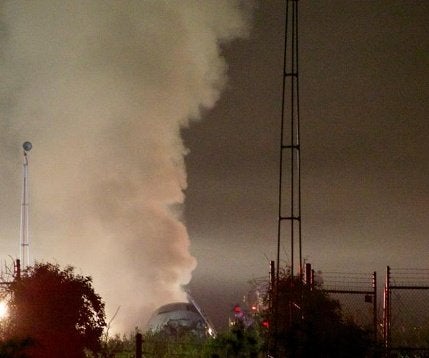

A study conducted by NBAA has found that 15 percent of flights in business jets begin without a complete flight-control check, the association reported last week. The NTSB suggested a need for the study after its investigation of a fatal 2014 accident involving a Gulfstream G-IV at Hanscom Field, in Bedford, Mass. The safety board found the crew had not performed a flight-control check before takeoff, and as a result, they had no way of knowing the aircraft’s gust lock was engaged. The jet ran off the runway and caught fire, killing all seven on board. The NTSB recommended that NBAA lead an industry-wide, collaborative study to measure the extent of non-compliance with before-takeoff flight checks.
