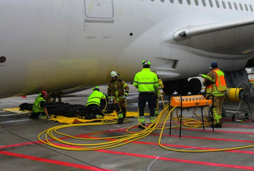

The Lufthansa 787’s nose, along with both engine cowlings, struck the concrete below. The forward fuselage also pressed down on a cargo high loader, injuring one person and damaging the loader and cargo-door area.
Recovery crews drained about 60,000 kilograms of fuel before they lifted the nose back up with an air cushion. The nose gear extended and locked as the aircraft was raised. The BFU has not issued a probable-cause determination, and the investigation remains open.
