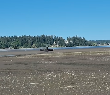

An RV-6A pilot’s apparent attempt to dodge a helicopter recovery bill for his stranded but undamaged airplane was upended last week with an ill-considered takeoff attempt from a muddy tidal estuary on Vancouver Island. He still ended up paying for the lift from the chopper but it hoisted a badly broken airplane. Canadian authorities are also now involved after video of the chain of events appeared a few days after the mishap. “We have been made aware of the incident … and we are collecting information,” the Vancouver Sun quoted a statement from the Transportation Safety Board as saying. “We have not deployed to the site of the occurrence, but we have been in contact with the pilot.”
The pilot, who has not been formally identified, put the homebuilt down on a flat expanse of wet sand near Comox, British Columbia, after running out of gas on July 1. After refueling the plane with a jerry can, he tried to take off but never got the airspeed he needed, and the nosewheel dug into the progressively wetter surface, briefly standing the homebuilt on its nose before it settled back on its gear. Bystanders helped him push it away from the incoming tide and a helicopter plucked it off the sand the next day. Local police said there were no injuries, no environmental damage and no charges pending. The TSB also said there were likely no aviation safety lessons to be learned from the mishap and has filed the incident in its archives.

  4. Seems like he might’ve had better luck if he had simply used the soft-field takeoff procedure everyone learns during primary flight training.
  5. Looked like the elevator was full nose-up from the start of the takeoff roll. What did he miss doing?
  6. Taking off the wheel pants would be a minimum “must do”; they’ll just pack up with mud.
    Installing larger tyres all around would be next on the list, since using full up elevator just loads even more weight down onto those tiny mains.

  17. He missed aborting the takeoff when the nose wheel didn’t come off the ground.
  18. Like all early C150s, mine was hopelessly under-powered. On soft or high grass fields, I used neutral elevator with flaps up to give me the best acceleration. At 5mph below Vso, I dropped 10 degrees and gently pulled back. Dunno if this guy did that, but full-up elevator is not going to get you off the ground earlier.

    He was driving an extra 100-200 pounds of weight down onto those main tyres with all that down force being generated by aft stick.
    For soft ground you want minimum drag on the wheels to gain speed quickly and then drop a little flap to unload the wheels even more. Yea, basically let it lift off flat and let it accelerate further in ground effect.
