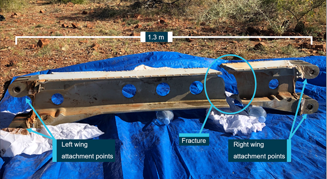

  • A 2019 fatal Cessna P210 crash, caused by a wing spar failure, was likely preventable if Cessna hadn't relaxed inspection requirements in 2011 from flight-hour based to a less frequent three-year schedule.
  • The Australian Air Transportation Board (ATSB) concluded the fatigue crack, exacerbated by the aircraft's high usage, would almost certainly have been detected under the previous inspection regime.

Australia’s Air Transportation Board says a fatal crash involving a Cessna P210 in 2019 likely would have been prevented if Cessna hadn’t relaxed inspection requirements for the wing spar carry-through structure on the aircraft eight years previously. The aircraft in question was being flown daily by a geophysical survey company when the beam broke, a wing separated and the pilot and passenger were killed. The plane was flown a lot and racked up an average of more than 1,000 hours a year in the previous six years and that was a factor in the crash according to the ATSB.
In 1992, Cessna began requiring regular eddy current and visual inspections of the spar based on hours flown, but in 2011 it determined that historical data justified changing the requirement to inspections every three years. “Had the previous flight-hour based eddy current inspection schedule remained in place, it is almost certain that the fatigue crack within the wing spar carry-through would have been detected before this accident occurred,” ATSB Chief Commissioner Angus Mitchell said. After the Australia crash, Textron, which owns Cessna, issued service bulletins requiring immediate inspections of the carry through structure and the FAA followed up with an AD, but the three-year schedule for subsequent inspections remained.
