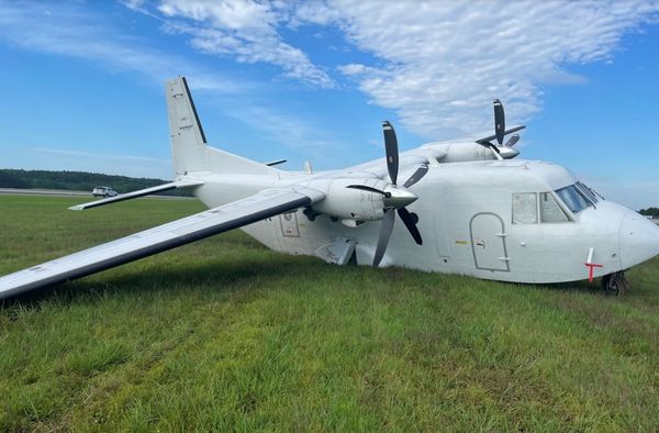

  • The incident began with a hard landing attempt, possibly due to windshear, which caused the aircraft's right main landing gear to separate and necessitated an emergency landing.
  • The official NTSB cause attributed the FO's fatal fall to his decision to leave his seat, with the board speculating he may have lost his footing while attempting to vomit near an open ramp door during turbulence.
The NTSB says there’s no conclusive evidence a young first officer intentionally jumped from a plane even though the captain reported it that way. Therefore, the board listed the cause of an emergency landing of the CASA C-212 skydiving plane at Raleigh Durham International Airport on July 29, 2022 as “the airplane’s encounter with windshear during landing, which resulted in a hard landing and separation of the right main landing gear, and the pilot’s subsequent decision to leave his seat in flight, which resulted in his fall from the airplane.”
The sensational nature of the tragedy earned it widespread coverage, especially after 911 tapes of FAA officials reporting the incident used the term “jumped” to describe the fatal fall of Charles Hew Crooks, 23, into the backyard of home in a Raleigh suburb. The FAA employees were relaying the perception of the aircraft captain in his radio calls to set up for the emergency landing of the twin, which was missing its right main gear. The report said that although that was the pilot’s impression, based on the demeanor of the FO just before the fatal fall, it couldn’t find that the fall was suicide. The gear broke off in the aborted landing attempt at a small airport in North Carolina, possibly due to wind shear. Crooks was flying at the time and the captain took over and diverted to Raleigh for the longer runway and emergency equipment.
