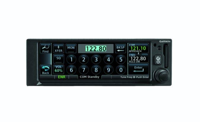

Like the 175 and 375, the new comm-equipped GNC 355 has a 2-inch-high bezel, which helps differentiate itself from the larger GTN 650 navigator, nor does it have a VHF nav receiver.
Like the other two budget units, the idea with the GNC 355 is to replace aging navigators without having to do much if any stack rework. Maybe there’s an old Apollo GX60, King KLN89B or even a King KX155. The GNC should easily fit in without restacking.
21 GNC355_(5) COM Standby
Like the other two units in the series, the GNC 355 is designed to work with a variety of third-party nav indicators. Remember, these boxes are WAAS equipped for full IFR GPS approach capability, so you still need an indicator to display course information. The new series has Garmin’s Connext wireless interface for traffic, weather and flight plan streaming to and from a tablet.
There’s a long list of compatible indicators-everything from Garmin’s own GI 106A/B to the King KI209 and KI525A HSI-even old Narco and Collins indicators. But we suggest asking your shop if these indicators are healthy enough to retain for reliable service. Some are not. The unit will also work with new stuff-including Garmin and Dynon EFIS.
The new touchscreen mapcomm is intended for Class I/II aircraft that weigh 6000 pounds or less, and can be installed under a 700-aircraft blanket AML-STC.
