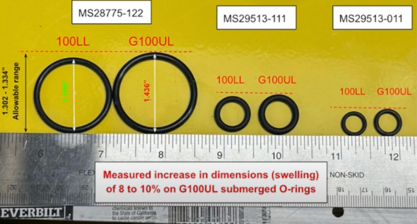

  • G100UL also caused new nitrile O-rings to swell beyond certified limits after prolonged submersion, prompting GAMI to recommend replacing nitrile components with silicone or fluoropolymer elastomers.

G100UL unleaded fuel appears to damage aircraft paint under specific circumstances, according to a California A&P who conducted his own compatibility tests on it and 100LL. Michael Luvara also said new nitrile O-rings swelled beyond certified limits when submerged in the unleaded fuel for five to six days. GAMI recommends replacing nitrile components with those made of silicone or fluoropolymer elastomers.
